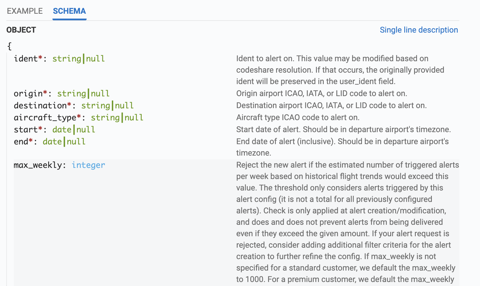

By selecting 'Schema', you will see a description of each parameter available. An asterisk, *, denotes that the field is optional. You can leave it blank or choose to delete it.
Go back to the 'Example' screen to input your parameters. The following are some things to pay attention to while creating your alert.

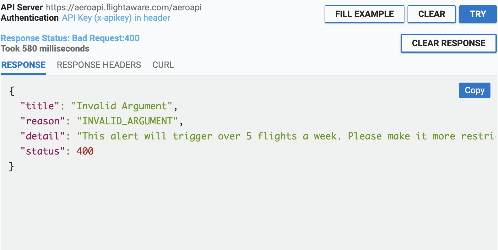

  • Max Weekly: this is the maximum number of alerts you want to receive. The less defined the parameters are, then the higher the max weekly number will be. Your max weekly number should reflect this. If the number is too small, then you will receive an error message stating so. Simply increase the number or add more parameters. By default, the max weekly is set to 1,000 for Standard subscriptions and 4,000 for Premium subscriptions.

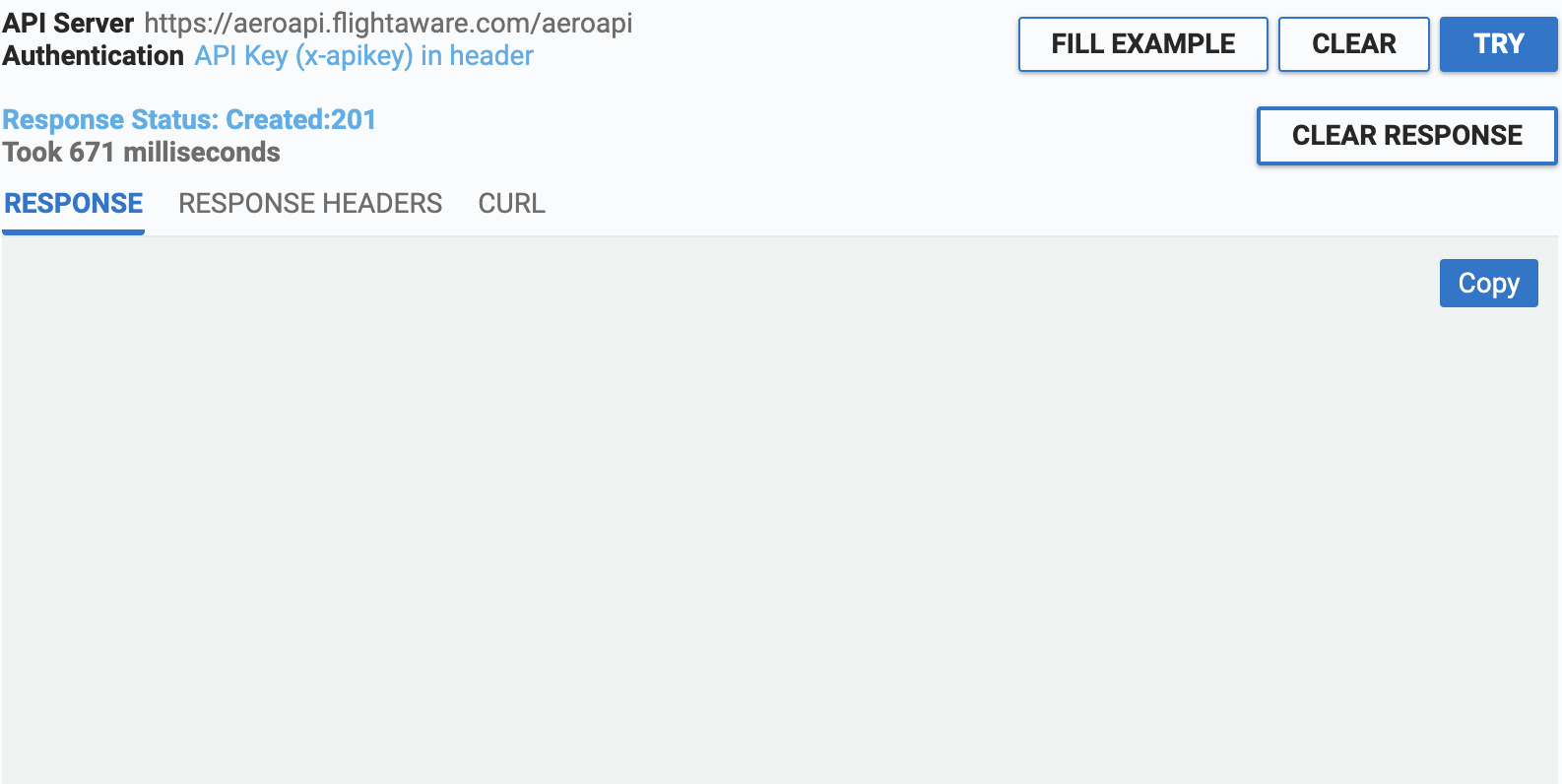

A successfully created alert will display a status code of 200.

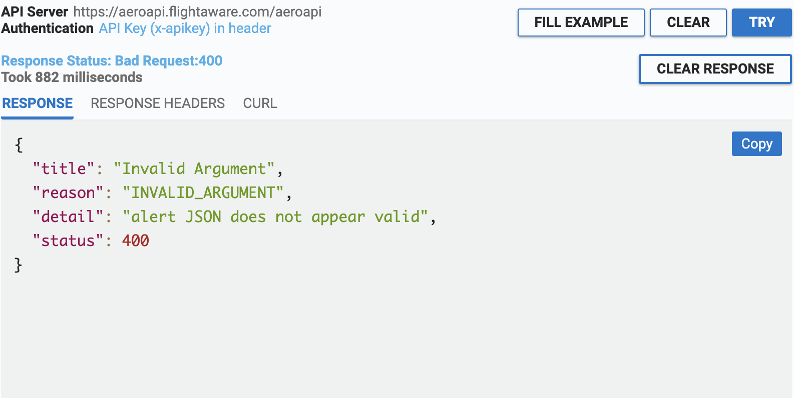

If an error was detected, then you will receive a status code of 400 followed by the reason it was not accepted.
If you receive the response mentioned above, then verify that there isn't a syntax error like a missing double quote, trailing comma, incorrect bracket, unsupported/conflicting fields in your payload. When testing via API UI portals Postman, the UI automatically fills optional payload fields with placeholder values like "start": "1970-01-01" or "eta": 0. AeroAPI tries to parse "1970-01-01" as a live time or "eta" and "impending\_arrival" simultaneously, failing validation and throwing 400 "alert JSON does not appear valid". We recommend deleting any optional fields you aren't actively configuring to keep the JSON request body minimal, see example below.
"ident": "DAL70",
"origin": "KATL",
"destination": "EHAM",
"max\_weekly": 1000,
"events": {
"departure": true,
"arrival": true,
 "cancelled": true,
"diverted": true
 "target\_url": "https://yourURL.net"
